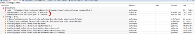

Please tell me the solution to the "selected processor does not support 'cpsie i' in ARM mode"...
1,570 Views
Jnoss
The error as shown in the picture below occurs when debugging.
I used S32K144 and S32DS 3.4!
If you know the solution, I would appreciate it...ㅠㅠ

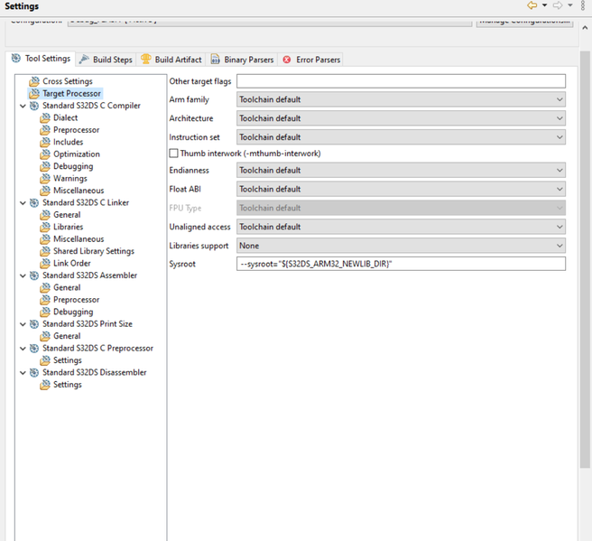

Hi @Jnoss,
The S32K144 CM4 does not support ARM mode.
What target processor is selected?
How did you create this project?
