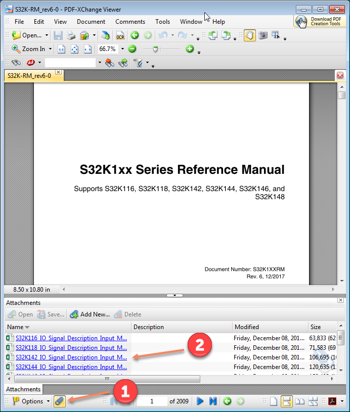

I am trying to find out the Pinout diagram for S32K142, but there is no much information about that. The section 4.6 Pinout diagram section  in Reference manual is blank. Can anyone please help out in this ? #s32k142#s32k help

there's excel file attached inside the reference manual:
https://www.nxp.com/docs/en/reference-manual/S32K-RM.pdf
