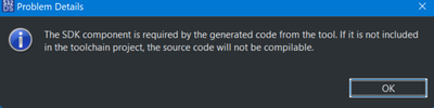

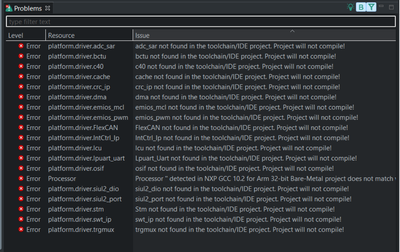

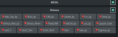

I'm having a problem with the tools provided with the SDKPlatform for S32K344 MCU. I'm using RTD v2.0 and S32 DS for S32 Platform v3.4
I've deleted all the files and folders that are generated from the tools in order to test if it will create/compile them. It worked as it should but I get those messages at the tool's view.
My project's structure is this:
main.c and other files are in some other folders above this folder but they are added into the resurces files so the build system can find them and compile them. My project compiles as it should but I don't know if those errors should be like this.
Can you guide me of how I can fix this issue ?

Hi @kyf
Yes, it may be a possibility.
To ensure this is not the cause, check that in the project properties -> Resource -> Linked Resources all paths match the actual lotions and names.

VaneB
Hi @kyf
First, I recommend you clean the project. If you still have any errors, the most viable option is to generate a new project and copy the application source files from your pre-existing project as well as any customizations you made to the project properties.
