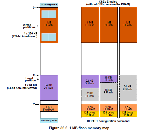

Hi All,
I am trying to partition the FlexNVM like 32 kb for D-Flash and 32 kb for E-Flash.
The DEPART value is 0x3 .
Q. Which part of the 64 kb of FLexNVM will be allocated for D-Flash?
Is it the 1st 32 kb of FlexNVM or the 2nd 32 kb of FlexNVM?
2,627 Views
danielmartynek
It is as shown below, DFlash starts at 0x10000000.
