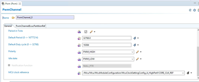

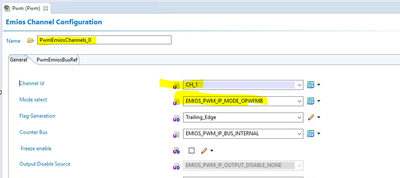

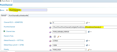

Hi All,
I am using S32K358 board and have configured 4 PWM Output Channel in OPWFMB mode with the same clock pre-scaler and configurable Period (Variable Period) for all the PWM output channels using EB tresos  listed below:
 EMIOS_0_CH_3 = MSCR 130 = GPIO 130 = PTE2
 EMIOS_0_CH_1 = MSCR 45 = GPIO 45 = PTB13
 EMIOS_0_CH_4 = MSCR 48 = GPIO 48 = PTB16
 EMIOS_0_CH_2 = MSCR 46 = GPIO 46 = PTB14
Saw the below formula from one of the queries raised in community,
PWM frequency = CORE_CLK / global pre-scaler / internal pre-scaler / (B1+1)
"B1 is a value written to channel B register."
But as per this calculation, I was not getting the output frequency and is mismatching with the actual generated signal (verified its frequency through oscilloscope).
Below are the values that I set in PWM module:
CORE_CLK = 240MHz | OPWFMB Mode |
Global Pre-scaler: 44 (Clock Divider value set in MCL module - EMIOS0_CH23)
Internal Pre-scaler (Clock prescaler): 2
Kiran_Gowda_8-1682441279699.pngKiran_Gowda_8-1682441279699.pngKiran_Gowda_9-1682441293951.pngKiran_Gowda_9-1682441293951.png
As per the formula, I got 340.8664Hz (240MHz/ (44*2*(8000+1)), but what I got from the oscilloscope was having 3.67kHz for 50% duty cycle. (Reg-A value: 4000h & Reg-B value: 8000h).
Kindly help me to understand, how the PWM frequency being calculated.

The formula you found in the post is correct. What I can infer from your configuration is that the Prescaler Clock Source (UCPRECLK) should be set to EMIOS_PWM_IP_PS_SRC_PRESCALED_CLOCK so that the eMIOS channel clock is CORE_CLK divided by the Global Prescaler (GPRE).
Hope it helps you.

Hi, It worked after configuring the Prescaler Clock Source (UCPRECLK) to EMIOS_PWM_IP_PS_SRC_PRESCALED_CLOCK .
Thank you for your support.
