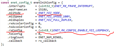

I am using S32K148EVB to prototype a test bench setup, while I have some question related to external loopback test on PHY. I made a board to interact with S32K148EVB via existing Samtec connector like figure below.

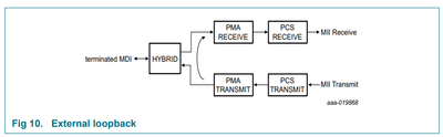

I aim to do PHY external loopback test on TJA110 as datasheet mention below with MII mode and compare the transmit eth frame and recev. eth frame.
I use the 4.0.1 SDK example code (enet_loopback) as a start. Add Initialization for PHY and register setting of TJA1100 which are good, however, I couldn't send data to my TJA1100 which I suspect my ENET init config was wrong.
For this test, I only changed .miiMode from ENET_RMII_MODE to ENET_MII_MODE and leave .rxConfig stays same as figure below.
I am wondering is there any suggestion how to initialize the ENET to realize the function I want?
should I also set .rxConfig = 0 and enable something else.?
2,857 Views
PetrS
yes, the .rxConfig should be 0 to do not use internal loopback on ENET.
BR, Petr
