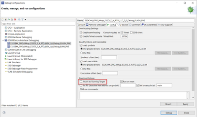

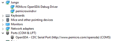

I'm unable to connect to S32K3X4EVB-T172, despite following the Quick Start Guide: https://www.nxp.com/document/guide/quick-start-guide-for-s32k3x4evb-board:GS-S32K3X4EVB-Q172

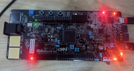

Board and LEDs:

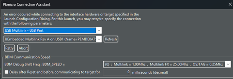

When attempting debugging, the PEmicro Connection Assistant shows up.
Device Drivers:

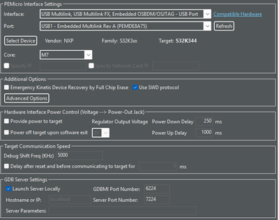

Debug Settings:
Already tried changing data cables, changing computers, reinstalling S32DS, reinstalling Drivers, trying P&E Micro Utilities.
Windows 11, tried on S32DS 3.6.4 & 3.6.1
S32K3X4EVB-T172 S32DS-S32PLATFORM OPENSDA

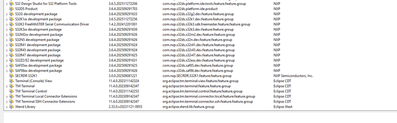

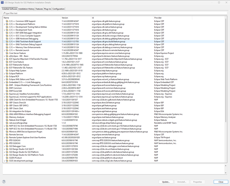

_Leo_
Thank you for your interest in our products and for contributing to our community.
Let's take a step back first, please.
Please an screenshot of your "Installation Details", which you can find in "Help" tab of the IDE.

zaighamkhawaja
Sure, here it is:

232 Views
Julián_AragónM
Hi @zaighamkhawaja,
Thank you for sharing your installation details. It seems both S32K3x Dev. package and PEmicro plugins are correctly installed. Is this the first time trying to connect to the EVB? Was there any project uploaded to it before?
I can see from the picture both LEDs RESET_K3 and RST_OSDA are on. Is RESET_K3 always on when powering the board? Are you able to measure it? Usually when the reset LED is on, the line is being pulled for a really short period of time periodically, keeping the MCU on reset.
Also, measure the voltage sources, if these do not provide the expected value this means that the MCU could be damaged.
If you have any external debuggers available (PEmicro, JLink, Latuerbach, etc.), you can try using them instead to see if any connection is possible.
RESET_K3 and RST_OSDA are OFF initially when I connect the board following the power-up procedure. When attempting to debug, the RST_OSDA (and sometimes RST_K3) LEDs turn ON while simultaneously getting the PEmicro Connection Assistant popup.
Also, if I press the SW4 and then retrying debugging, I get this different popup:
I've already tried with 2 different adapters: 12V-4A and 12V-5A, getting same results. The adapter voltage output is stable.
- If you mean the S32K3 MCU getting damaged: The default application (LED color changing) is still working on the board.
- If you mean the NXP K26 getting damaged: I'm still able to upgrade the firmware using the "Multilink Firmware Config Utility" to usbmlacpembeddedens.1098

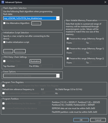

Does this happen with a blank or an example project? As a last chance, have you tried to attach to the MCU instead of trying to debug/erase?
This leads me to believe either HSE is installed, or the debug port is locked and needs to be unsecured by password or challenge/response. PEmicro provides Python scripts to authenticate the debugger at the start of each session; however, the password is needed.
Last resource can be to swap MCU to confirm if debug interface is faulty, or the MCU is secured/disabled debug pins.
