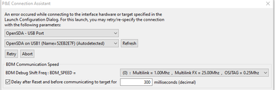

I am using S32DS 3.4 and S32K14WEVb-Q064 and I keep running into this error while trying to debug. Any help?
Thanks in advanced.

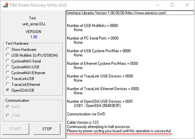

If the MCU is powered, then check the state of RESET_S32K(Does RED led D1 blinking? Whether there is a low level pulse on pin 1 of J104 or TS7?) If click Debug in S32DS still not able to connect MCU, then I am afraid you need to use the P&E Recovery Utility.

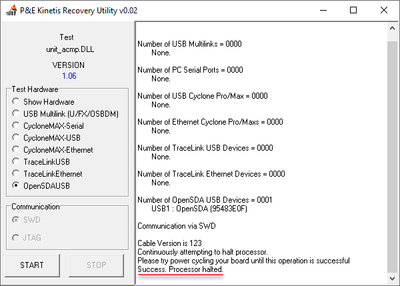

Please try to use P&E Recovery Utility halt MCU by refer to Recovering Cortex-M Microcontroller with a Power Glitch.
External power J16 can be used to power cycling MCU(connect Pin1-2 of J107). If you don't use external power, then connect Pin1-2 of J107 and use J10 power cycling MCU.
After halt the MCU, you should be able to debug it with S32DS.
