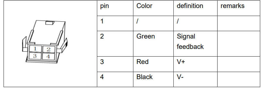

I have a module (Steering Lock). Which operates in a single wire communication protocol.
So, i am having trouble to figure out how to enable the communication between the module and my S32k146. The following are my queries .
1. Wiring Connection:
The above is the wiring details of the module. So the signal feedback wire (green), to which pin of the S32k146 i can connect this and how can i enable that signal in embeded terms based on the current.
2.Establishing Communication.
The fowwling is the lock vendor provided example. How can i acheive this

Hi @akhilranga,
Unfortunately, there are no examples for one-wire communications for the S32K platform. You can implement this communication by connecting a GPIO from the MCU to your module, such as the following posts:
Also, using FlexCAN module there is no difference, but the CAN bit rate must be modified, and a different transceiver must be used, such as this one: Single-Wire Can Transceiver. Whichever protocol you choose is up to your implementation.
The scope of support for this public community is for NXP related devices. Please contact your vendor for documentation on which protocol to implement, or any related information.
