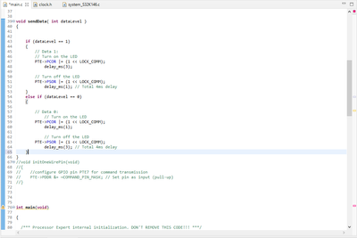

akhilranga
Hi @Julián_AragónM
With your input i was able to close all the issues and started testing the code. But while testing i noticed that my code was not passing throught the delay_ms function. It is completly skipping this dealy_ms function which was called in the senddata function and skipping on to the next line of the code. can you please help me identify what might be the issue. Please cherck out the code as mentioned in the thread.
2,215件の閲覧回数
Julián_AragónM
Hi @akhilranga,
It seems you are missing a closing brace in your sendData function:
Julián
2,209件の閲覧回数
akhilranga
thank for the input. I over looked that error.
