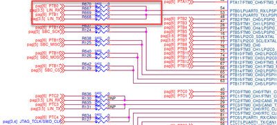

I am trying to test the sample LIN Slave configuration as provided by NXP SDK but as they are not using the LIN connector on S32K142 Eval Kit I have changed the code to use the LIN Connector (LPUART0 and PTC2 and PTC3 pins).
I have loaded the ldf in CANoe to configure it as Master but the CANoe given error saying slave is not responding.
I am attaching the code and ldf that I am importing in CANoe, please let me know if I am missing anything.
Also let me know if anything else needs to configured in CANoe.

what kind of board revision you have?
On rev.C LIN transceiver is connected to PTD6/PTD7 only.
On rev.D there could be more options but as per schematic, by default, it is connected to PTB0/PTB1 using zero Ohms resistors
So try to select PTB0/PTB1 in pin muxing component.
Also be sure board is using external 12V power supply so LIN transceiver is powered.
