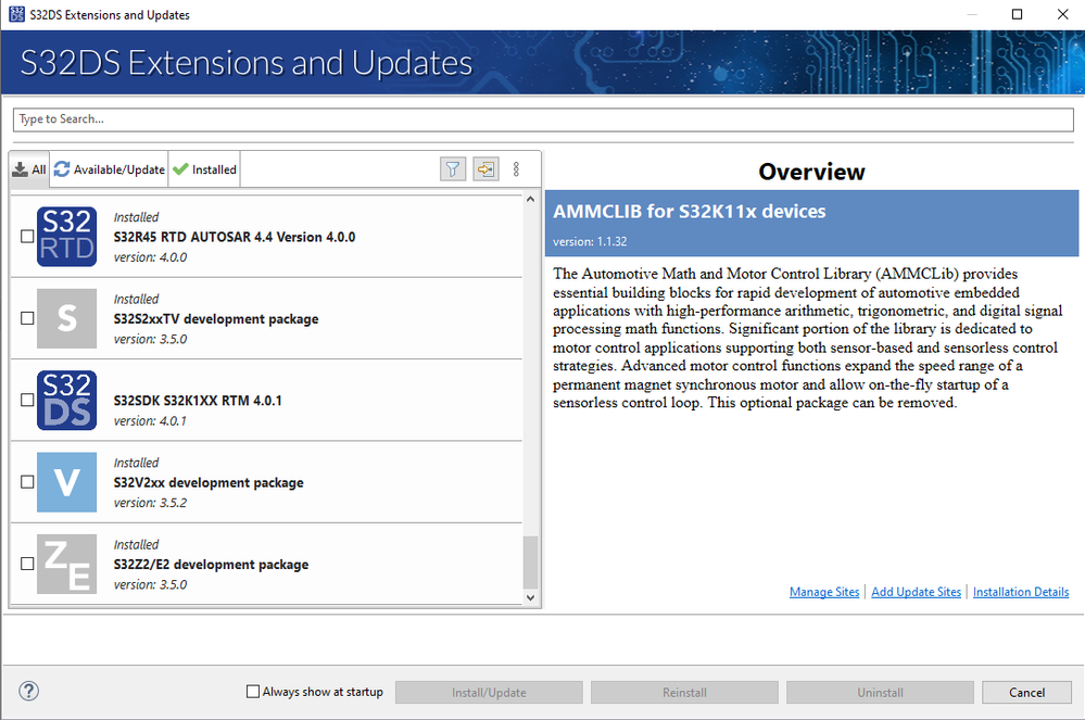

As far as I remembered, we don’t have any plan to integrate S32SDK S32K1XX 4.0.3 into S32DS 3.5 or above version.
2,005 Views
emb02
Contributor V
Thank you for your response.
I am not able to install - S32K1 SDK RTM 4.0.3. There is no option for installing SDK 4.0.3.
Can you please guide me further to install SDK.
EMB02
1,991 Views
Robin_Shen
S32K1 SDK RTM 4.0.3 is not available in S32DS v3.5, please install it in S32DS v3.4.
Sorry for the inconvenience we bring you!
1,981 Views
emb02
Contributor V
Can S32DS v3.5 will be updated with SDK RTM 4.0.3 in upcoming days?
EMB02
1,978 Views
Robin_Shen

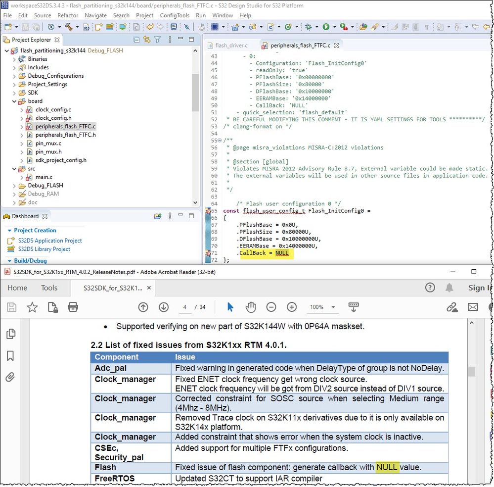

Robin_Shen
Hi EMB02,
Please use S32K1 SDK RTM 4.0.3 with S32DS v3.4. From S32SDK_for_S32K1xx_RTM_4.0.2_ReleaseNotes.pdf you can see that a Flash issue has been fixed: Fixed issue of flash component: generate callback with NULL value.
List of fixed issues from S32K1xx RTM 4.0.1 generate callback with NULL value.jpg
