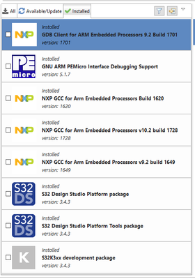

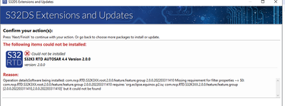

Hi, I am trying to install latest RTD package for S32K3 on my system but i am getting error in installation.
Here is the error message,
Support packages currently installed:
Am i missing any package or can you please tell me what wrong i am doing ?
Thank you

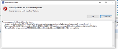

shubh1006
Hi Mike,
Sorry for the late reply as i was away from work for few days.
I tried the solution you suggested but i am still getting the error, please check the SS of error.
Shubham
1,697 Views
mikedoidge
Hi Shubham,
Could you provide the workspace log file? It should contain more details on what package is missing.
("C:\Users\<WinUserID>\workspaceS32DS.3.4\.metadata\.log")
