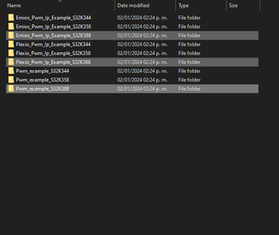

I tried to configure EMIOS PWM for S32K388, but it is not working.
Need steps for configuring EMIOS PWM for S32K388. May be I am missing something.
I am using S32K388CVB-Q289 Evaluation board. I am trying this PWM as EMIOS on UserLED_2.
Anil
1,000 Views
Julián_AragónM
Hi @anilsp31PA,
You can find PWM examples under: "C:\nxp\SW32K3_S32M27x_RTD_R21-11_4.0.0\eclipse\plugins\Pwm_TS_T40D34M40I0R0\examples\S32DS\S32K3XX" from your RTD installation,
These examples support the XS32K388CVB-Q289 PCB RevA SCH RevX3 board. You can follow the description.txt file included in the examples and compare configurations.
