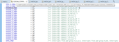

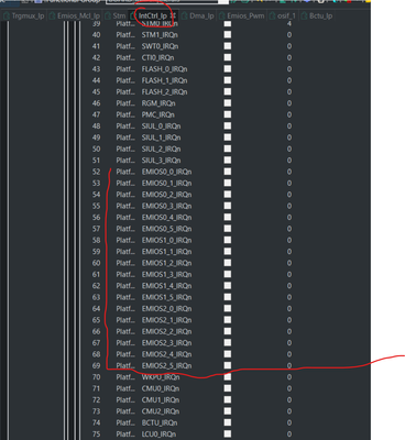

Regarding the screenshot bellow:
1. Is EMIOS0_0_IRQn refered to eMios 0 channel 0 ?? or this is an other interrupt ?
2. Is there any document where I can find descriptions regarding the eMios interrupts except reference manual ?
3. Is interrupt priority set only withing the "peripheral tool" ?
4. Is there any handler for handling the priorities of the interrupts and their priorities ? OR this is done by hardware ?

1) four channle's interrupt requests are ored into single vector in eMIOS and EMIOS0_0_IRQn belongs to channels 23,22,21,20
2) it is in S32K3xx_interrupt_map.xlsx attached to the RM, also visible in project
3-4) priority is set either in the component you shown or a IntCtrl_Ip_SetPriority function can be used, i think.
BR, Petr
