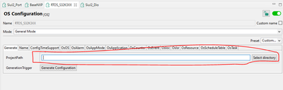

I am trying to build the example project for S32KXX OS but it does not compile, can you help?
I face this error:
../RTOS_S32K3XX/ssc/inc/Os_prop_autosar_api.h:47:17: fatal error: Os_prop.h: No such file or directory
2,917 Views
MVR
Contributor V
Sure, I faced this problem.
You have to select the project directory in this field:
And generate the configuration. After that compile it. You need to compile with Debug_RAM (I don't know why).
2,913 Views
spara7c5

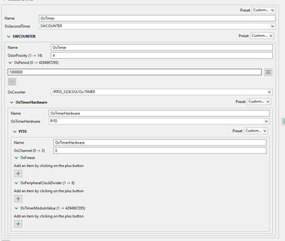

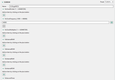

Can you help me with a timer problem?
I'm trying to set the tick duration to 1ms, but I'm not able to do it.
I made this configuration on the timer:
The result is:
Where am I making a mistake? Can you help me, please?
Thank you!
