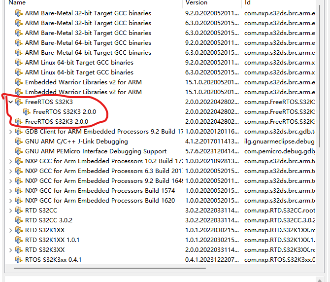

SCoder41
Why is the red box part missing from my software,os part and middleware part

Hi @SCoder41
Check if you can find it in the "Previous" tab.

VaneB
Hi @SCoder41
Just to confirm, did you install the FreeRTOS and TCPIP packages compatible with your RTD version?

SCoder41

Hi @SCoder41
To install this TCPIP package, you require the FreeRTOS package version 1.0.0 release for S32K3 platforms, which supports FreeRTOS Kernel v10.4.5. This can be downloaded through S32K3 Reference Software -> Automotive SW - S32K3 - FreeRTOS.

SCoder41
I do not see 10.4.5 in S32K3 Reference Software -> Automotive SW - S32K3 - FreeRTOS.

Hi @SCoder41

SCoder41
I had installed,but I'm not sure if the version I installed is correct or not
