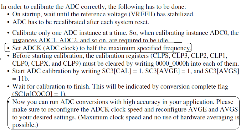

SDK version: EAR_0.8.4
Driver API: ADC_DRV_AutoCalibration
Issue: ADC_DRV_AutoCalibration does not set ADC clock divider to dividing by 2 before starting calibration sequence. However, according to S32K144 ADC specification, this step is essential:
Although we can manually configure ADC clock before and after calling ADC_DRV_AutoCalibration, I believe the SDK API should finish all the required tasks, rather than leaving a essential step to the customer.
Hope NXP can clarify:
Whether the future SDK will incorporate this step, or the customers still have to manually configure ADC clock upon calibration?
