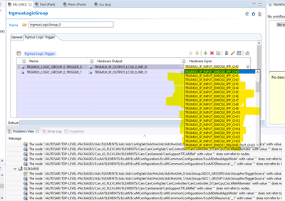

Mcl_Trigger Mux Group was there  in that Group From TRGMUX_IP_INPUT_EMIOS1_IPP_ 0 to 15 ,22 and 23. If i want Select the Trgmux_Logic_trigger Hardware Input of emios channel to Hardware Out of Lcu0. currently Im using Emios Channel number 21,22. So which Trgmux Logic Trigger Input i need to select for channel num 21 and 22.

Hi@gadilinga
"But That Channel Suggested NXP only."
what does it mean? Can you show me a screenshot?

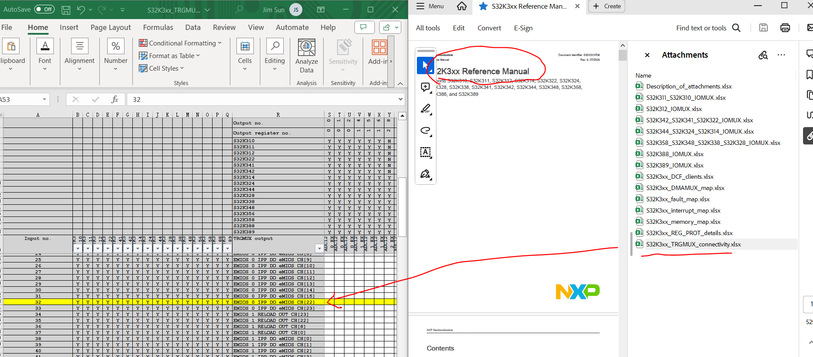

Senlent
Hi@gadilinga
Actually you can see what channel can be used in TRGMUX.
and EMIOS_0_IPP_DO_eMIOS_CH[21] can not be used for TRGMUX input.

Senlent
Hi@gadilinga
This is not a problem. eMIOS's CH21 cannot be used as the input of TRGMUX. What you can do is to change other channels.

gadilinga
Hi @Senlent,
Thank u For Ur Quick Response towards the the Solution. It doesn't mean that NXP , It mean Each Emios Instance Have 24 Channels, So if U see the TRGMUX Connectivity 0 to 15,22,and 23 channels only in TRGMUX logic Group. If i use Emios Out of 23 channels why 16 to 21 channels Input not Available in that Option. .
