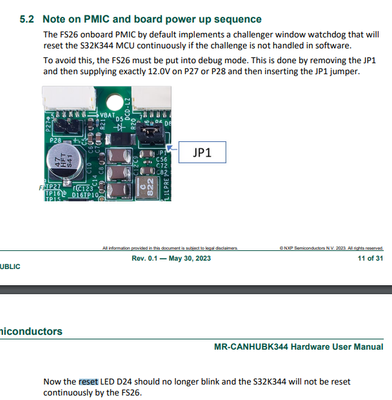

I have an MR-CANHUBK3 board with an S32K344.

After that, I cannot upload any code to the device.

****** Error: DAP error while reading AIRCR.
Error occurred: Could not connect to the target device.
For troubleshooting steps visit: https://wiki.segger.com/J-Link_Troubleshooting
J-Link>10
Unknown command. '?' for help.
I see that the board's reset light is blinking every second. I suppose the FS26 is resetting the S32K344, so that is why I can't do anything to the board.
I saw there are reset options in the hardware manual:
But that doesn't work for me. I use a 12V power supply, I removed the pin, turned on the power supply and inserted it again and nothing.
How can I upload a new code which fixes the clock and stops the resetting process? Are there any other potions to stop the resetting process so I can upload code?
