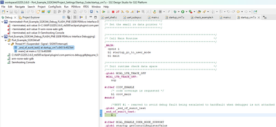

Hello all,
I am using the S32K3X4EVB-T172, connected through USB - OpenSDA (J40) and with +12V power supply.
I installed s32DS 3.6.0, Platform_Software_Integration_S32K3XX and SW32K3_S32M27x_RTD_R21-11_5.0.0.
I tried examples from S32K3XX Autosar R21-11 RTD 5.0.0, in particular the example Port_Example_s32k344.
After building and launching the code, the user led lights red (as coded in the example) but the program immediately suspends with the SIGTRAP, as seen in screenshot.
I have the same SIGTRAP problem with the example Uart_Example_S32K344 which also uses MCAL .
I don't have the problem when I try the example Siul2_Port_Ip_Example_S32K344 which does not use MCAL. I can run this example perfectly.
Can you help me understand why this SIGTRAP appears in MCAL examples ?

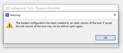

Adding complementary info on my post:
I use the unmodified example project "Port_Example_S32K344".
I have this warning when I open example_Port.mex for the first time
I didnt modify the debug pins set in "UnTouchedPortPin" in Peripherals menu.

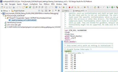

And when the SIGTRAP interrupt triggers, i have the following content inside the MC_RGM registers :
I am stuck here, I can't run the MCAL example.

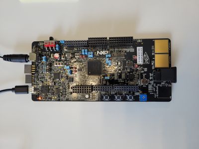

can you share your full project with elf as well so I can test.
Also share board picture to check jumper setting you have.
BR, Petr
722 Views
pba_lcx
Hello Petr,
Here is my example project. It has the sigtrap error when i compile and program on the eval board.
Also here is a photo of my eval baord. As far as I can tell, the jumpers are still in their default position.
