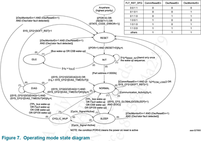

On the MC33772B, under SPI communication, a local write command is necessary just as mentioned for the MC33772C. however, different from the MC33772C, the MC33772B, upon receipt of a "go to sleep" command, if the IC is being performing a conversion sequence, then the state transition is delayed until an EOC occurs (end of conversion); else, the state transition occurs immediately. In other words, the device goes to sleep mode only after all conversions in progress are completed.
If you check the attached state diagram image for the MC33772B, to go from normal mode to sleep mode, it is not only required to set SYS_CFG_GLOBAL[GO2SLEEP] bit to logic 1, but also EOC should occur (end of conversion).

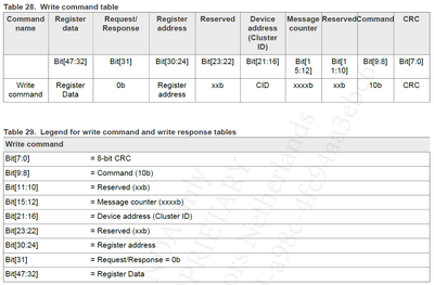

reyes
Can I ask which version of the datasheet are you looking?
I’m looking into the version Rev. 3 — 4 June 2021 of the MC33772C (can be downloaded from NXP DocStore) where section 10.4.2 ‘Local Write Command’ specifies:
“Unlike the read command, for which MC33772C responds with data, the write command
does not generate any response. When the slave receives a valid local write command,
the message is acted upon but no response is generated”
And tables of this section (image below) doesn’t specify anything about an echo response.
There are no preconditions to write SYS_CFG_GLOBAL[GO2SLEEP] bit to logic 1, this should be straight forward and the MC33772C should go into sleep mode when setting this bit. As you can see in the  state diagram image below, to go from normal mode to sleep mode, the only requirement is to set SYS_CFG_GLOBAL[GO2SLEEP] bit to logic 1.
Jose
