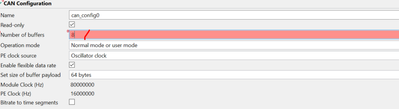

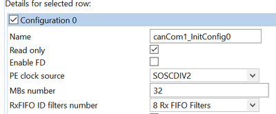

i wonder if the Configuration parameter: Number of buffers of Can_PAL in S32DS 3.4 platform, is the same meaning of the configuration parameter: MBs number of FlexCan in Processor Expert ?

Hi@samcs
Checked the driver code, the meaning of these two parameters should be the same.
/* Configure features implemented by PAL */
 flexcanConfig.max_num_mb = config->maxBuffNum;

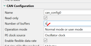

While, Number of buffers in CAN_PAL_Component, be limited to 7, why in PE, the MBs number can be set to 32?

Hi@samcs
1. The size of the payload will affect the number of Buffers
2. Can you provide your demo code? I may need to follow your method to reproduce the problem.
