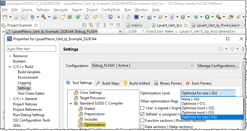

Do not call strncpy((char *)Rx_Buffer,(const char *)UserData,50);  The received data already in Rx_Buffer. For the detail, please check the Lpuart_Uart_Ip_GetData in Lpuart_Uart_Ip_RxIrqHandler.
Change the Optimization Level from -Os to -O0 or -O1.

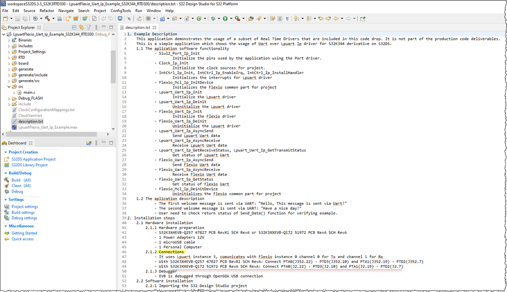

Did you modify the LpuartFlexio_Uart_Ip_Example_S32K344 example? If not, did you follow the 2.1.2 Connections of description.txt? With S32K3XXEVB-Q172 51972 PCB RevA SCH RevA: Connect PTA0(J2.22) - PTD3(J2.10) and PTA1(J2.19) - PTD2(J2.7)

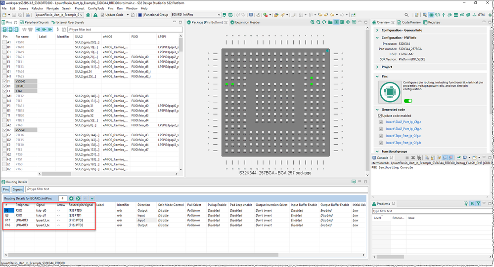

Sorry. The Connections in description.txt is wrong. This project actually uses these pins:
If it still doesn't work, try updating S32K3 RTD 3.0.0 P07 and test it again.

Robin_Shen
Would you please connect PTD0(J37.3) - PTD3(J2.10) and PTD1(J37.1) - PTD2(J2.7) and test it again?
I don't have an S32k3x4EVB-Q172 development board, but when I connect the signals on S32k3x4EVB-Q257, the Flexio_Uart_Ip_AsyncSend() function returns the FLEXIO_UART_IP_STATUS_SUCCESS status.
According to description.txt, no TTL converter or Putty application is required to test this example.

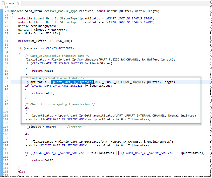

Robin_Shen
You don't have to call Send_Data, Send_Data is to implement FlexIO_UART and LPUART communication. If you just want to receive data from LPUART3_TX(PTD2), Lpuart_Uart_Ip_AsyncSend can be called to achieve it.

Robin_Shen
