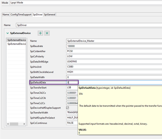

Hello NXP team,
I want to use LPSPI on s32k148. I try to configure LPSPI unit using "Design Studio" and it generates a the file "Lpspi_Ip_Sa_BOARD_InitPeripherals_PBcfg.c" which contains all configuration parameters in some structures. One of the structures inside the file is:
 static Lpspi_Ip_DeviceParamsType Lpspi_Ip_DeviceParamsCfg_BOARD_InitPeripherals[1U] =
(uint8)8U, /* Frame size */
(boolean)FALSE, /*Lsb */
(uint32)0U /* Default Data */
#if (STD_ON == LPSPI_IP_HALF_DUPLEX_MODE_SUPPORT)
, LPSPI_IP_FULL_DUPLEX /* Transfer mode - dummy value */
#endif
One of the parameters in the structure is the "Default Data". The problem is that I cannot find any thing about the "Default Data" in the LPSPI "Memory Map and Registers" section of the S32K reference manual.
Would you please explain me that which register controls the "Default Data" ?
I am developing my own LPSPI driver and need to know if there is such a bit or register in the LPSPI unit.

Hi @Jembed,
The default date are written to the TDR (Transmit Data Register) in case the TxBuffer pointer is passed as NULL to the transmit APIs.
