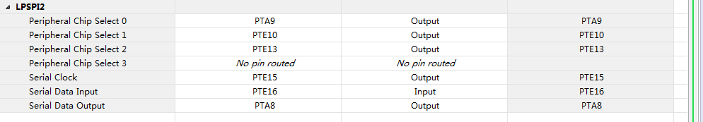

Hello, My project uses SPI2 to connect three slave devices, use LPSPI_PCS0, LPSPI_PCS1, LPSPI_PCS2, how to send and receive data to each slave device.
LPSPI_DRV_MasterInit(SPI2_0, &masterState, &lpspiCom3_MasterConfig0);
LPSPI_DRV_MasterInit(SPI2_1, &masterState, &lpspiCom3_MasterConfig1);
LPSPI_DRV_MasterInit(SPI2_2, &masterState, &lpspiCom3_MasterConfig2);

jia_xuan
The problem is solved, the use of any one slave device, you must re-initialize the configuration data, and then you can send and receive data. thank you all.

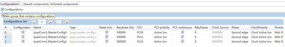

jia_xuan
Look at my configuration map
const lpspi_master_config_t lpspiCom3_MasterConfig0 = {
.bitsPerSec = 500000U,
.whichPcs = LPSPI_PCS0,
.pcsPolarity = LPSPI_ACTIVE_LOW,
.isPcsContinuous = true,
.bitcount = 8U,
.lpspiSrcClk = 8000000U,
.clkPhase = LPSPI_CLOCK_PHASE_2ND_EDGE,
.clkPolarity = LPSPI_SCK_ACTIVE_LOW,
.lsbFirst = false,
.transferType = LPSPI_USING_INTERRUPTS,
.rxDMAChannel = 255,
.txDMAChannel = 255,
const lpspi_master_config_t lpspiCom3_MasterConfig1 = {
.whichPcs = LPSPI_PCS1,
.bitcount = 8U,
.lsbFirst = false,
const lpspi_master_config_t lpspiCom3_MasterConfig2 = {
.whichPcs = LPSPI_PCS2,
.bitcount = 8U,
.lsbFirst = false,
I was wondering how to initialize and how to call a function to receive and send data to each slave

razva_tilimpea
The first paramter of the LPSPI functions is the instance number.
You want to use only one LPSPI device to control all the slaves or you want to control each slave with one master device?
