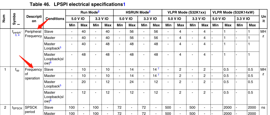

1.)What is the difference between peripheral LPSPI frequency (which is 56MHz in HSRUN mode) and frequency of operation (which is 24 MHz or 14 MHz, depending of which voltage you have)?

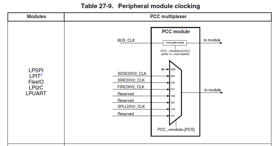

There are three clocks.
LPSPI bus interface clock is always BUS CLK gated by PCC module, see Table 27-8 RM rev12.1.
BUS CLK can be max 56MHz in HSRUN.
Peripheral functional clock is also configurable in PCC[PCS]. The frequency must be less or equal to BUS CLK.
Then in LPSPI module the functional frequency (56MHz) is divided using a prescaler in LPSPI[TCR] register. If set to 0, it divides the functional clock by 1 (56MHz).
The SPI bit rate is set by SCK divider in LPSPI[CCR] register. The division factor is equal to SCKDIV + 2. It means the bit rate can be set theoretically to 28MHz.
But as you can see in S32K DS the bit rate is limited to 14MHz in HSRUN in order to sample data coming from a slave.
Using Master loopback feature (CFGR1[SAMPLE]) which delays SCK clock for sampling the slave data, the bit rate can be set up to 24MHz provided the MCU runs at 5V power supply.
If you can set only 4MHz, you probably set something wrong. Please check all the registers mentioned above. And make sure the MCU is in HSRUN, if you use it.

what is the different between Peripheral Frequency andFrequency of operation or what do they mean?
4,266 Views
danielmartynek
Hi weiq@stec-cn.com,
The Frequency of operation is the bit rate on the SPI bus.
Peripheral frequency:
4,266 Views
weiq
The Frequency of operation is the bit rate on the SPI bus. I see max Frequency of operation is 10MHZ。Is meaning that SPI bit rate max is 10MHZ?but why  LPSPI the bit rate can be set up to 24MHz
4,266 Views
danielmartynek
It can be 24MHz in HSRUN mode if the loopback feature is enabled.
In RUN mode without the loopback mode, the bit rate can be up to 10MHz only.
