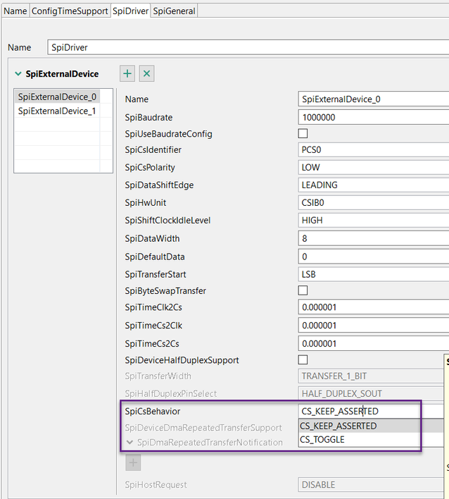

I'm interfacing S32K3xx with an external flash memory. This chip requires different size command and data combinations. For example, to read the status register one needs to send 1 byte command and wait for 1 byte of data to appear on the MISO line. Frame size can range from 8 bits to several bytes. Is there a way to interface this chip without needing changing FRAMESZ each time?
In the above example, I couldn't just send 1 byte of command. I had to send an extra dummy byte to allow for the memory chip to respond. So, my frame size had to be 16 bits long. I have other use cases where I am sending 1 byte of command + 3 bytes of address + 10 bytes of data (just an example). It seem like each time my data changes I have to modify the FRAMESZ.
Another question: It seem like to get correct data in the SPI data register I have to read that register each time I send out a frame. Is this how the SPI set up?

Hello Vusal,
I understand you need to keep CS asserted throughout the whole 14-byte transfer (using the example, 1 byte of command + 3 bytes of address + 10 bytes of data).
For that, the LPSPI Continous mode can be used (TCR[CONT = 1]).
FRAMESZ can be set to 8bit frames.
The LPSPI will keep CS asserted until a new command with TCR[CONT = 0].
RTD LPSPI_IP driver
Call the function below with Length = 14.

Hi Daniel,
Thank you for your message. This fixed the issue.
One more quick question: It seem like to get correct data in the SPI data register I have to read that register each time I send out a frame. Is this how the SPI set up?

There is 4x32b RX FIFO disabled by default.
