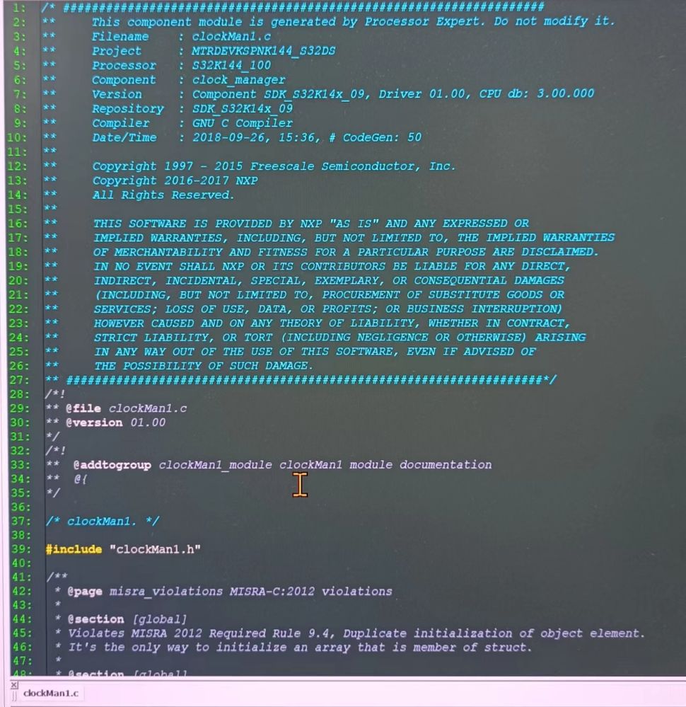

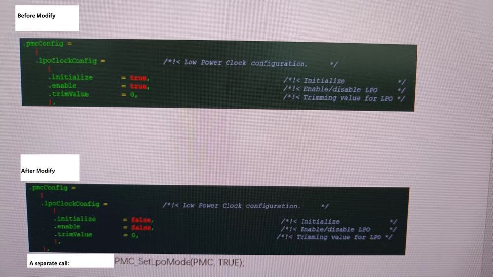

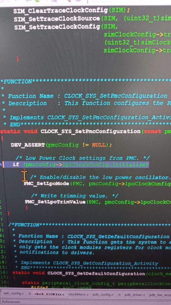

Does it mean that the value will be dynamically adjusted at the NXP factory? Does typ 128 written in the S32K-RM refer to the adjusted value instead of 0x00?Can you add this note to the S32K-RM? During initialization, the demo code changes this value,so we found the problem of clock out of range. Now we don't initialize,we just call PMC_SetLpoMode(PMC,TRUE);Is this modifcication OK? Or any other suggestions?
SDK_S32KXX_RTM_4.0.0;Version:component SDK_S32K14x_09

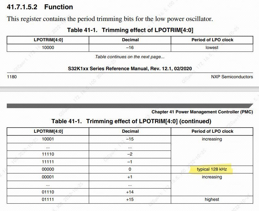

The LPO is trimmed to a frequency close to 128kHz in the production, and LPOTRIM is loaded during the reset from the flash.
Regarding the problem with the demo code, I suggest you to update the SDK version to S32K1xx RTM 4.0.3. This software contains new features and also fixes issues with previous SDKs.
Please try using this new SDK and let me know if this makes any changes to the functionality of the project.

Spec show 0 = typ 128k,but it's actually adjusted to 128k,could you add a remark here?

The LPO frequency depends on process variations, and there are huge differences part-to-part. That is why the default value of LPOTRIM is not 0b00000, this is loaded during the reset from the flash.
You can read the register on you board, overwrite it, use CLKOUT to output LPO.
One LPOTRIM step is ~3kHz difference.
