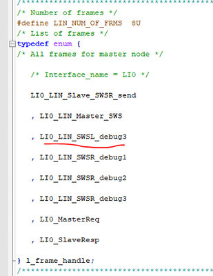

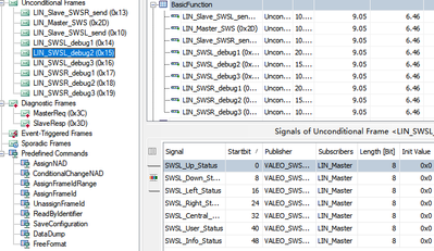

based on s32k118, ide is s32ds, generate lin code by lin stack,this is my LDF file
I choose right node to generate right lin cfg
but I can see LI0_LIN_SWSL_debug3 frames of left node, do you know why ? if include left node ,why not include LI0_LIN_SWSL_debug1 and LI0_LIN_SWSL_debug2 ?

could you share LDF file you are using in S32DS?
