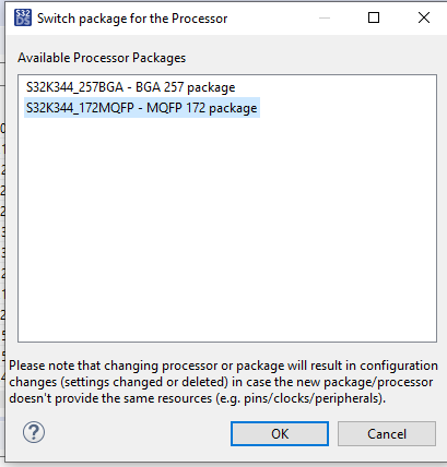

I am working on LIN configuration for s32k344 in S32DS. I have took the example Lin_Ip_FrameTransfer_S32K344 from S32K3 RTD AUTOSAR 4.4 2.0.0 D2203 Example projects for S32K344 in S32DS 3.4. The code is building fine with 0 errors but ain't getting the output in Saleae Logic Analyzer. I haven't done any changes to the configurational settings in s32ds, just updated the code and flashed it into the S32k344 using PEMicro Debugger. Also cahnges from 257 to 172 package. What changes are to be made to get the data frame in the Logic analyzer. I'll attach the configuration in Logic analyzer too. Hoping a reply and thanks in advance.
