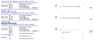

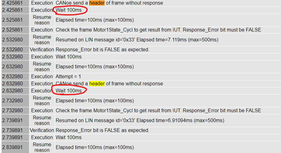

Hello guys, any idea why the 3rd test failed?

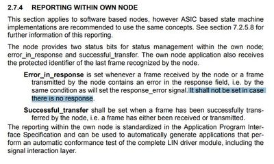

The spec is saying:
But in the nxp source code I found:
Is this correct?

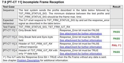

First picture is a description of the test.
Second picture is from LIN 2.1 Standard

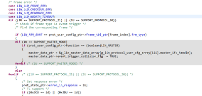

Third picture is from lin_common_proto.c, version S32SDK_S32K1XX_RTM_4.0.2

this is a feedback I got from SDK team...
Following the LIN 2.1 Standard specification, the Error_in_response bit shall not be set in case master no response.
Anyway, I have checked the issue on my side based on your information. However, it seems I cannot reproduce your issue. The Error_in_response was not set after master sent header only.
  • The header that was sent by Master.
  • Check the driver code lin.c:
We only have LIN_LLD_NODATA_TIMEOUT when slave node has received the header and at least one byte of data.
From my point of view, maybe we have other error on the bus(LIN_LLD_FRAME_ERR, LIN_LLD_READBACK_ERR…) not NODATA_TIMEOUT. You can set a break point on the lin_handle_error() function to know the exact error on the bus.
So please recheck the test case on your side and make sure that master node has sent header successfully and no response after that.
If the issue is still not resolved, please let me know how I can reproduce it (send me your test case if possible).
BR, Petr

Here is the actual test:
The test was done by a 3rd party company and I can not reproduce it on my system because I can't manage to send only the header using CANoe in order to debug it.
BR, Gabr

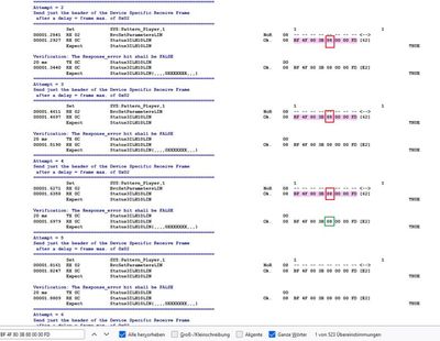

Unfortunately for the test case 11.3 the Response Error bit is set 523 from 760 attempts:
And in addition to that with these settings:
we see sporadic missing responses for the below tests:

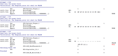

[11.1] Send only the break field
[11.2] Send only BREAK and SYNC
[11.3] Send just the header of the Device Specific Receive Frame
Any idea where the problems could be?

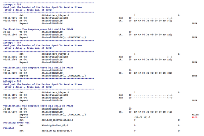

I see in your test that after you send only the header you wait 100ms and then check for the status:
But in the ISO 17987-6 standard it's saying that the wait should be frame max. time. and that is 9ms (8 byte frame the delay of T_Frame_Max = 173 Bit = 9 ms at 19200 Baud.)
On our side it's working also with more than 20ms, but that's not correct.
BR, Gabr.
