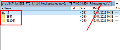

Other question is that i cannot find the file for S32 opening but only finding the example file for EB,as is the attached picture showing,i have downloaded the updated software package which updated time is April,2023 ,what is the point of this problem?Thanks!
Well hard to say. I could be that there are no S32DS examples. But the sample SW is usually provided directly in plugins:
