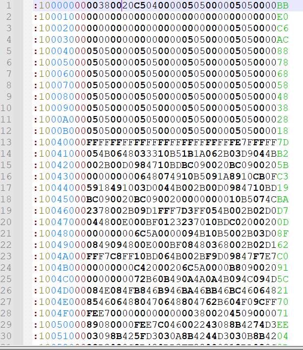

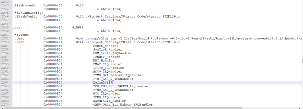

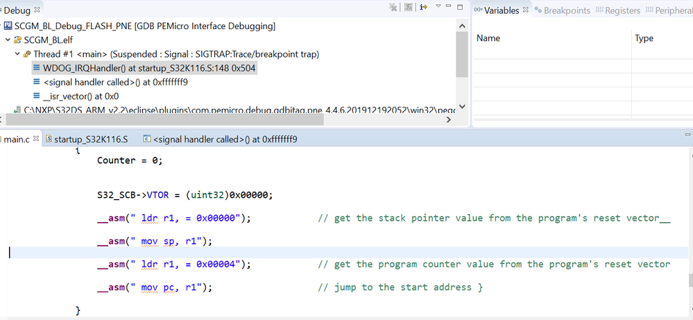

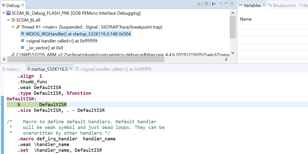

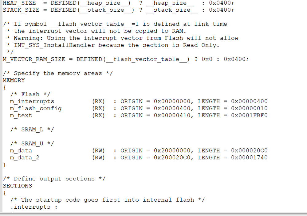

Jump instruction is not working in s32k116 evolution hardware.
After the jump instruction code stops at DefaultISR:
for your kind information WDGT not enabled in the software.
please find the below pictures for reference:
Jump Instruction:
Hex File:
Map File:
Linker File:
