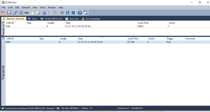

f-nelson
Hi NXP:
many thanks for your modified. In this mornring, I tried to modify flexCAN protocol clock to 24Mhz as FIRC clock source and adjusted bit rate to 500kbps, and then it can works about CAN bus function by LA or PCAN-viewer, but it still has some strange data wave of CAN-RX. just now I used your modified workshop for testing and the result is the same. Do you have any ideas of CAN-RX pin? thanks.

f-nelson
Hi Senlent:
Sorry,it's my fault.I found an issue about Logic analyzer. I used scope and LA at the same time,
and scope is normal no strange wave, so I changed another channels of LA and wave is perfect,thanks again.
