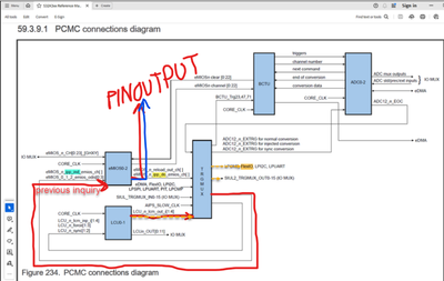

If I understand it wrong, please draw a picture and tell me the signal direction.

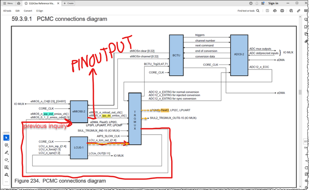

Ok, so it is the very last part of the same image (marked in blue now).
I can see that emios 0 channel 7 has the rerouted signal using emios_Icu and signal measurement functions. This part works great.
But when I try to take an output out of the redirected signal into my board now, I don't get any output at PTE7 (configured in PINS tool to emios_0_ch_7). I can do the same with ease with the other emios channels, and i removed the EMIOS_ICU now to make sure that wasnt the problem. I don't understand if I am wrong here cause as per the image i am assuming the SIUL2 config should do the rest.

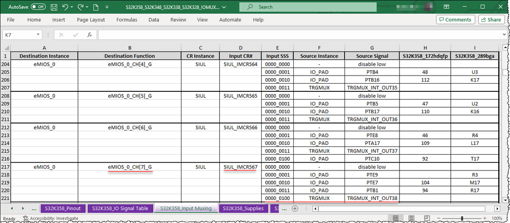

The input signal of eMIOS0_CH7 was selected by Input SSS=0000_0100 as TRGMUX_INT_OUT38. At this point, the input signal of eMIOS0_CH7 has no relationship with other pins (PTE7 \ PTE9 \ PTB1).

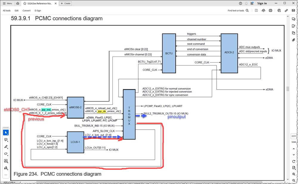

Sorry for the incorrect information in my first reply. The FlexIO in the diagram can only be TRGMUX_IP_OUTPUT_FLEXIO_EXT_IN_TRG0-4, and cannot be fxiod11. If you really need to output TRGMUX_IP_INPUT_LCU0_LC0_OUT_I1 to a pin, perhaps you accept the option TRGMUX_OUT0-15

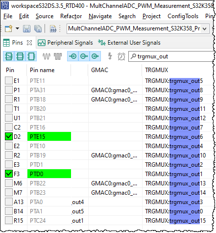

In Pins Tool, you will see that trgmux_out0-15 is located on these pins.
