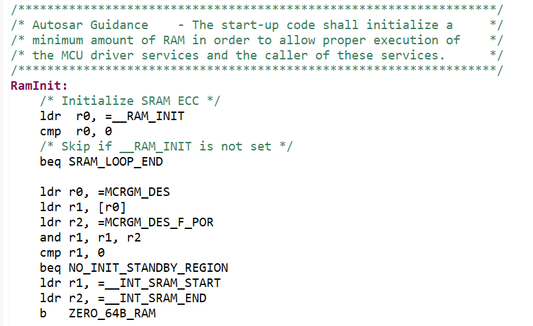

Thank you for your guidance. Upon further investigation, I discovered that the startup_cm7.s file includes a section for initializing the shared memory, but it is conditionally compiled under #if defined(MULTIPLE_CORE) && defined(MULTIPLE_IMAGE). By updating the assembler preprocessors to include these definitions, I was able to resolve the issue, and the IPCF initialization now works correctly even after a power cycle. Please see the attached images for reference.

It’s possible that the issue is caused by uninitialized SRAM ECC.
Typically, SRAM ECC is initialized by the debugger. If the debugger is not used, the application must handle ECC initialization in the startup code. Failing to do so can lead to ECC faults when accessing uninitialized memory.
To verify this, try checking the memory at address 0x20482008 (BFAR value of the precise bus fault) in the memory view. Do you see ?? at that address?
If so, it likely indicates an ECC fault due to uninitialized memory.

I've attached the memory view screenshots for your reference—one taken right after starting the debugger, and another captured after a power cycle when the HardFault occurs. The address 0x20482008 does not show ??, but I noticed that the values at this location are different between the debugger session and after the power cycle.

Regarding documentation of SRAM ECC, there is just the S32K3xx reference manual and this AN13388: https://www.nxp.com/webapp/Download?colCode=AN13388
However, you can refer to any RTD example project.
The SRAM ECC is initialized in the startup code.

Hi Daniel,
