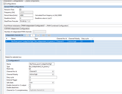

I want PWM output as well as PWM input but facing issue.
When I add ftm_pwm module and after configuration pwm is working but after adding ftm_ic module getting issue. PWM Output is not getting updated.

Currently I checked for PWM output. PWM example is working fine (ftm_pwm_s32k142) but when I copy the same configuration in my project then it is not working. PWM is not getting updated it is taking default assigned value only.
Is it issue with PWM clock? In my project CAN, Timer, Watchdog, ADC and Power manager modules are used.
If it is issue with clock then how to increase the PWM clock.
I am getting 28000 as max frequency for PWM.

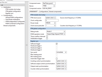

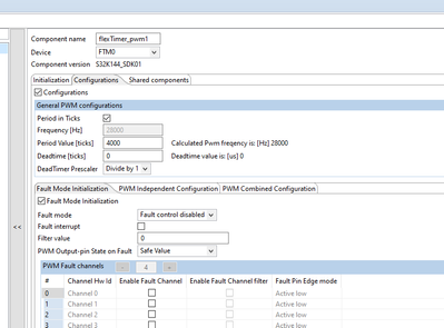

chaitanya_kalyani
Hello @PetrS
Thank you for quick response.
Below is my settings
chaitanya_kalya_1-1617021262535.pngchaitanya_kalya_1-1617021262535.pngchaitanya_kalya_2-1617021277453.pngchaitanya_kalya_2-1617021277453.pngchaitanya_kalya_3-1617021295324.pngchaitanya_kalya_3-1617021295324.png
5,575件の閲覧回数
PetrS
I do not see issue within setting.
BR, Petr
