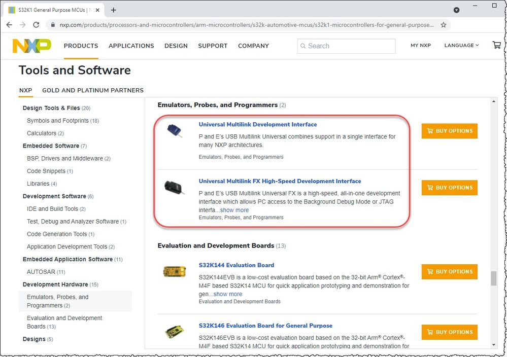

Hi Poley,
Do you mean that you want a list of external debugger programmer?
P&E Universal Multilink and Universal Multilink FX are recommended.
But S32K148 Debug Connector(J10) is standard 20-pin Cortex Debug D ETM connector, so I think almost all debuggers that support Cortex M series should be able to support S32K148.(for example: SEGGER J-Link\ I-JET \ ULINK...)
Robin

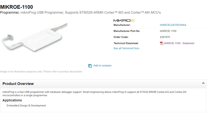

What Cortex M (3 or 4 for example) needs to be supported for it to work with S32K148?
Will this work with S32DS to program my board?:
https://uk.farnell.com/mikroelektronika/mikroe-1100/debugger-mikroprog-stm32/dp/2281670
Thanks!
2,409 Views
Robin_Shen
I am not able to open this link. Would you please let me know what it? The keyword in that link seems for STM32.
2,405 Views
Poley
Contributor V
It's this:
2,399 Views
Robin_Shen
Please contact mikroe about whether S32K148 is in the support list. After input S32K148, it seems not in the support list.
