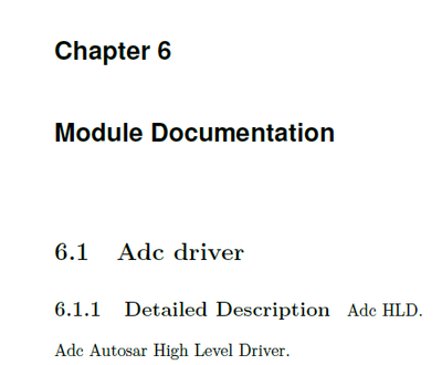

All drivers for the S32K can be found under the directory: \S32DS.3.5\S32DS\software\SDK_PATH\. To access the "Integration Manual" and "User Manual" for each driver, I can navigate to the "doc" folder. The User Manual consistently contains a "Module Documentation" section, which provides every information I need.

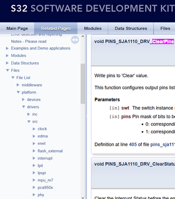

For the SJA1110 this is different, a completed Doxygen for the SJA1110 is available within the SDK folder:
Is there maybe a similar Doxygen available for the S32K-SDK, or am I out of luck?

The S32K3 and S32K1 RTDs just have the "Integration Manual" and "User Manual" that you already mentioned.
The ones that have Doxygen are the SDK for S32K1.
