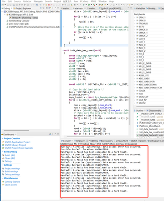

Yongdong
I generated one, but the following error is reported:
371 Views
Julián_AragónM
Hi @Yongdong,,
Could you please try a simple basic project? I've generated a new empty project with S32DS 3.6.0 RTD 6.0.0. Please try to upload it to your custom board.
Julián
356 Views
Yongdong
It has been resolved using RTD 5.0. Thank you!
