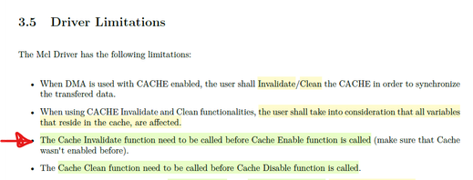

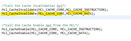

  • The issue happens when I invalidate the Data cache before using it As suggested by the MCL_UserManual
  • When I call the api [Mcl_CacheInvalidate()] for the Data cache
  • The : - BCTU Stops working -ADC Stops working -Some PWM Signals stopped working

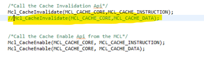

  • While If I comment the Call -> Everything works fine

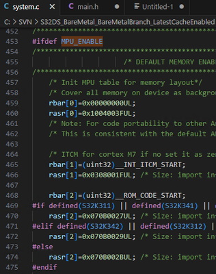

Yesterday I made more debugging in the SW , turns out Cache and MPU are already enabled by the startup code
inside the file [system.c] , it checks for some macros to either enable or not [I-Cache, D-Cache , MPU]
And those macros are already defined in the project settings
- I think the issue when I was calling [Mcl_CacheInvalidate] there are already data added to the data cache and this results removing these data which affects the peripherals

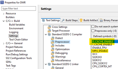

-To test the Theory:
  • I removed the data and instruction cache enable macros from the project settings
  • left the MPU to be enabled by the startup code and removed the MPU Configuration from the MCL
  • made sure that the startup code is not enabling the cache
  • Enabled the cache support in the Mcl Configuration
  • and call the functions [Mcl_CacheInvalidate] and [Mcl_CacheEnable] as before right after the Mcl_Init()
  • Everything works fine and the issues with the [BCTU,PWM and ADC] are solved !!!

Thank for the update, your observation makes sense.
If the MPU and cache are configured by the MCAL Platform and MCL drivers immediately after startup - before any real-time peripherals begin operation - there should be no issues, especially if the MPU settings in both the startup code and the application are consistent.
