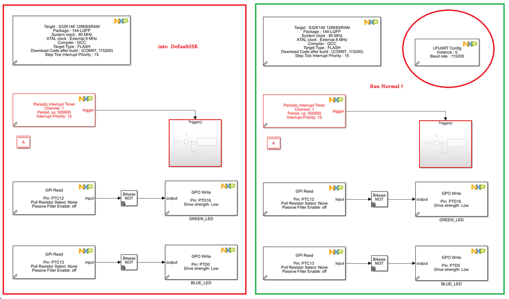

wjandsq
When I add the lpuart module to the MATLAB model, it runs correctly, including LPIT0_Ch0_IRQ interrupt。
but  once I remove lpuart module,  the application in 0x00020000 offset  is error,   it  dead in  DefaultISR.
I think the was startup_S32K146.s bug,   S32K144.s is OK.
