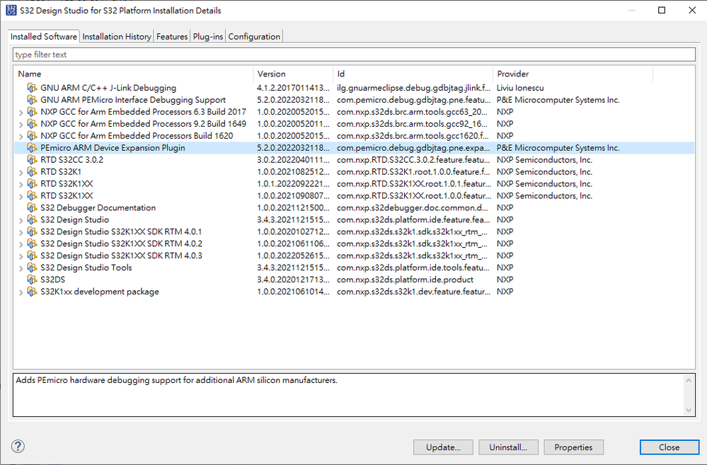

I got the same problem and worked around.
Just uninstall the latest update of PEmicro as below.
And reinstall the previous version of them.

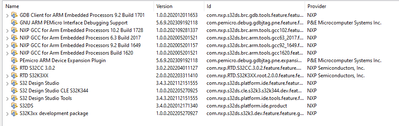

Hi, where can you find an old version of the plugin or how did you roll back? I can not debug anything since the update.
thank you

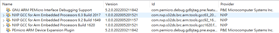

RickYeh777
Two places to uninstall.
1. Help->Installation Details
2.Help->S32DS Extensions and Updates
Help->Install New Software, to get the previous version, 5.2.0.20220321...
But if "C:\NXP\S32DS.3.4\S32DS\tools\gdb-arm" is cleared, you maybe need to run the install program of S32DS again.

   I have the error described in this thread and have tried to revert the components to the version in the thread but I only have access to a more recent subset of the components. Is there a way to get access to the "older" version that may work? I am not sure if I have another problem in my configuration so I have included what I have seen other threads mention.
Below are the versions of the debugging support and device expansion plugin I can access from the software installer.
This is my version of S32 Design Studio below and my installation details.
Thanks in advance.
