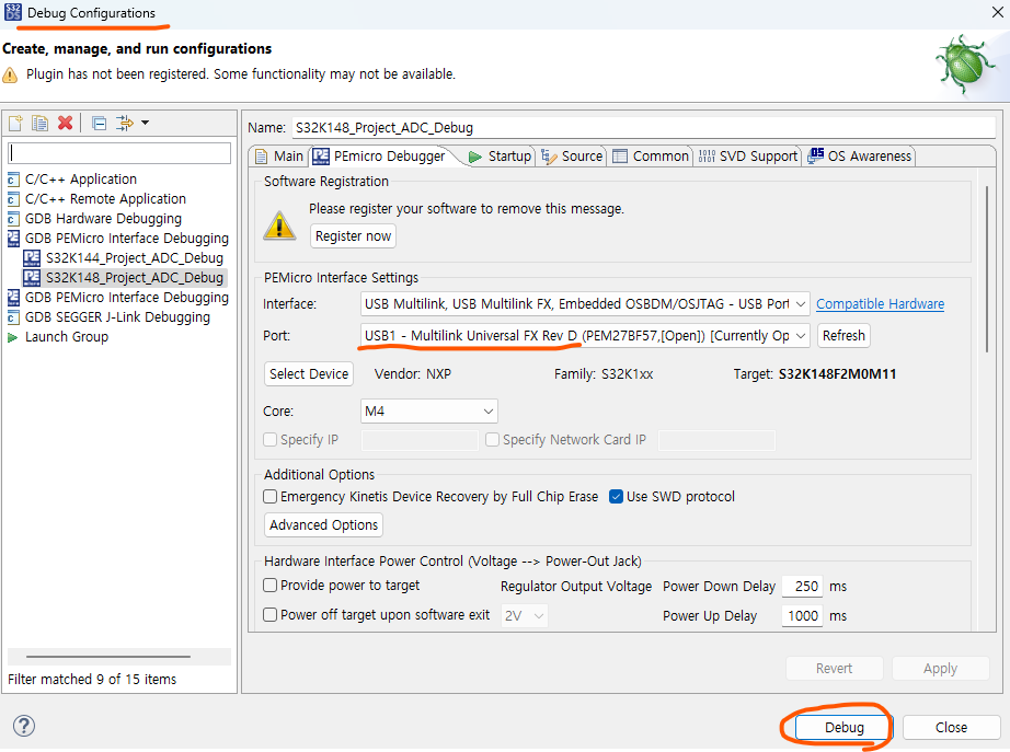

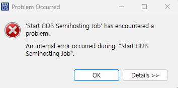

Hello.
When I click Debug configurations and press Debug to flash, the following error occurs.
It flashed normally until yesterday, but this has been happening since today. What can I fix?
Note1. The same error occurs when both USB Multilink and OPENSDA are selected in Interface.
Note2. I already referred to the link below. I uninstalled PE micro, and then reinstalled it again. (But the older version does not appear, only the latest version appears. So I installed the latest version)
https://community.nxp.com/t5/S32K/Internal-error-during-Start-GDB-Semihosting-Job-on-S32DS/td-p/1730...
Note3. As shown above, S32DS does not enter debugging mode. However, under the following conditions, s32k144EVB and MCAT are connected.
condition : After cutting off the power supplied to the board, re-supply power to the board to make the board operate. -> Double-click the S32K_BLDC_Sensorless.pmp file on S32DS to open MCAT -> When I click the GO icon, the board and MCAT are connected.
OPENSDA doesn't work on S32DS, so why does it work on MCAT? (I think it stops during the flash process)
BEST REGARDS
trunie

The focus of my question is how can I flash the MCU (S32K144 or S32K148)? In this case, Should I reinstall S32DS?
trunie
