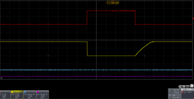

Dear NXP Support Team,
I am currently working with the S32K312 and using the eMIOS ICU in SAIC mode to measure a PWM signal. However, I am observing inconsistent and inaccurate results in the measured duty cycle and period time.
System Setup:
  • PWM Output Pin: PTA12
    • Configured using eMIOS_0 channel 8 in OPWMB mode
  • ICU Input Pin: PTC11
    • Configured using eMIOS_1 channel 1 in SAIC (IPWM) mode
  • Connection: PTA12 (PWM output) is physically connected to PTC11 (ICU input)
Signal Characteristics:
  • PWM frequency: 1 Hz
  • Duty cycle: 5 ms high time
  • Verified by oscilloscope: waveform is stable and correct
🧭 Clock Configuration:
  • Core clock: 80 MHz
  • eMIOS global clock: divided by 160 → 0.5 MHz
  • OPWMB prescaler: ÷10 → Tick = 20 µs (50 kHz)
  • SAIC measurement also uses BUS_DIVERSE, with same tick = 20 µs
Observed Issue:
  • The expected measured values (based on 20 µs ticks) should be:
    • PeriodTime ≈ 50,000 ticks
    • ActiveTime ≈ 250 ticks (5 ms ÷ 20 µs)
  • However, most of the time we observe:
    • ActiveTime = 285
    • PeriodTime = 285 (unexpected, matches active time)
  • Occasionally:
    • ActiveTime = 285
    • PeriodTime = 50000 (correct)
This suggests that in most cases, the period time is not measured properly and may be overwritten or missed.
Request:
Could you please help us understand:
  1. How to correctly configure eMIOS ICU in SAIC mode to reliably measure both ActiveTime and PeriodTime for low-frequency PWM input?
  2. Are there specific timing or synchronization requirements between the OPWMB and SAIC channels?
  3. Is there any known issue or workaround for measuring low-frequency PWM (e.g., 1 Hz) using this setup?
Attached below is the scope snapshot and software configuration if needed.
Thank you for your support.
