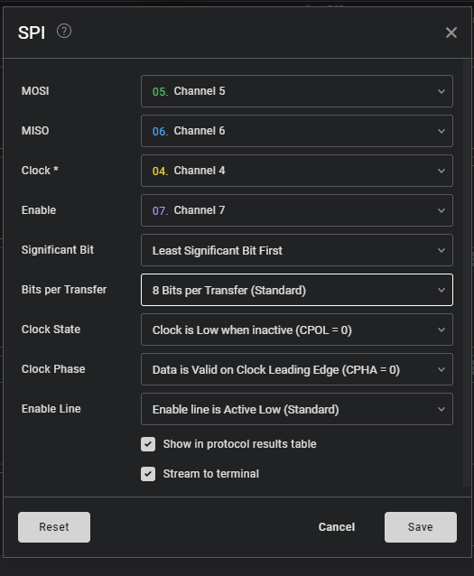

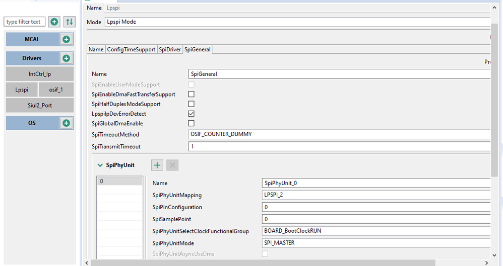

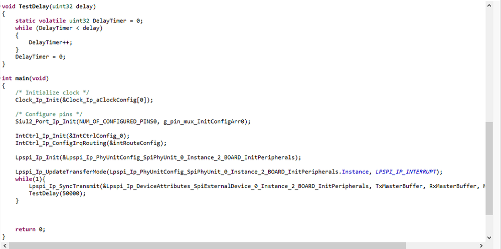

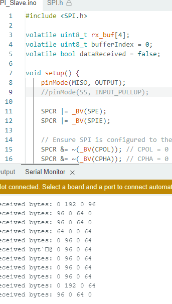

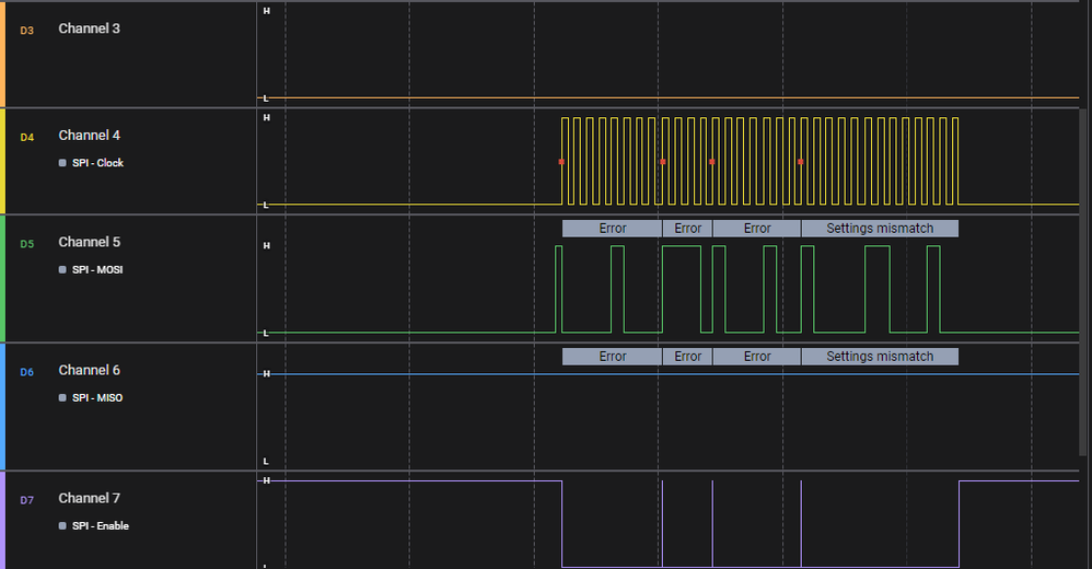

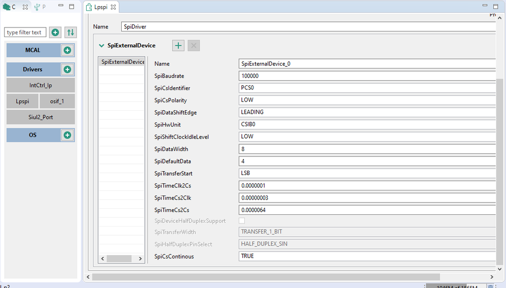

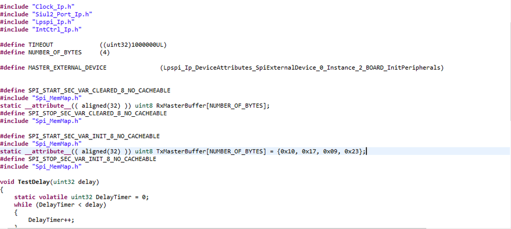

Hi there, I am facing troubles S32K3X4 Q172 EVB currently testing the SPI Functionality, I have configured the it as SPI Master, I am sending some data using the LPSPI2 Instance at slave side I am using the Arduino UNO and also the Logic Analyser But i am getting some Incorrect  data at arduino side and logic analyser.
This is my main code and Spi configurations at the master side and also the configurations that i put at the slave side .

int main(void)
    /* Initialize clock */
    Clock_Ip_Init(&Clock_Ip_aClockConfig[0]);
    /* Configure pins */
    Siul2_Port_Ip_Init(NUM_OF_CONFIGURED_PINS0, g_pin_mux_InitConfigArr0);
    IntCtrl_Ip_Init(&IntCtrlConfig_0);
    IntCtrl_Ip_ConfigIrqRouting(&intRouteConfig);
    Lpspi_Ip_Init(&Lpspi_Ip_PhyUnitConfig_SpiPhyUnit_0_Instance_2_BOARD_InitPeripherals);
    Lpspi_Ip_UpdateTransferMode(Lpspi_Ip_PhyUnitConfig_SpiPhyUnit_0_Instance_2_BOARD_InitPeripherals.Instance, LPSPI_IP_INTERRUPT);
    while(1){
    	Lpspi_Ip_SyncTransmit(&Lpspi_Ip_DeviceAttributes_SpiExternalDevice_0_Instance_2_BOARD_InitPeripherals, TxMasterBuffer, RxMasterBuffer, NUMBER_OF_BYTES, TIMEOUT);
    	TestDelay(50000);
    return 0;

Hi @Shivaprasad_sp,
I have already responded regarding this case in the following post Disturbance on Chip Select line - NXP Community
BR,
