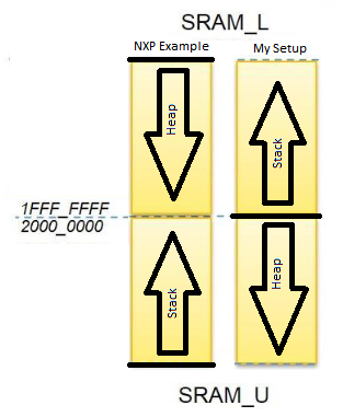

In the S32K14x series, SRAM is divided into two regions: SRAM_L and SRAM_U. Documentation explicitly mentions that SRAM_L extends downwards. Depending on the SRAM size, SRAM_L start address is lower to facilitate larger memories for SRAM_L. Documentation also states that SRAM_U extends upwards.
Documentation also states:
Misaligned accesses across the 2000_0000h boundary are not supported in the Arm Cortex-M4F architecture.
and
Burst accesses cannot occur across the 2000_0000h boundary that separates the two SRAM arrays. The two arrays should be treated as separate memory ranges for burst accesses.
Take also in account that
Accesses to the SRAM_L and SRAM_U memory ranges outside the amount of RAM on the chip causes the bus cycle to be terminated with an error followed by the appropriate response in the requesting bus master.
Taking all this into account, when looking at software development, SRAM_L to me sounds like the perfect place to put the stack. It extends downwards, so the starting address can be the same for any of the S32K14x series chips. SRAM_U is perfect for the heap in my eyes, as again the starting address can be the same for any of the S32K14x series chips.
This setup also steers clear of crossing the 0x2000_0000 boundary by growing away from it. In addition, if I ever cause a stack overflow, this will be detected; Instead of causing heap corruption, the stack in my setup grows away from the heap and into reserved memory ranges.
All seems clear as day.
However, I thought I'd take a look at S32DS' included example projects, and noticed the opposite is done there. The setup is more traditional, with stack starting at the top of SRAM_U, and the heap starting at the bottom of SRAM_L. So, heap and stack grow towards each other and towards the 0x2000_0000 boundary.
To me this makes no sense, and I was wondering if anyone could shed some light on why NXP decided to utilize the memory in this way. The argument could be made for having flexible heap and stack sizes, but SRAM_L and SRAM_U are not contiguous memory devices. The boundary limitation sounds like a pain, and the setup I described above provides robustness and portability benefits that NXP's setup does not.
So, my question is: what could the arguments for NXP's setup be?

I like your two diagrams that show the two areas either converging or diverging. I really like your idea of using the same start addresses for both, regardless of actual chip being used. However...
Ignoring the heap's actual start address as pointed out by danielmartynek‌, what your second diagram shows is that you're limiting both the heap and stack to less than what could be available. If not all the stack is required, the heap can't use it, and vice versa. The first diagram shows that a large heap and small stack, or vice versa, can co-exist gracefully.
In your version, if either "overflow" you get a hard crash when the processor accesses invalid memory. In the first version, you get a "soft" crash if the two memory areas collide - who knows what will happen! Which is "preferred" is up to the project...
While your point about the boundary between the two memory areas is relevant, what you seem to have missed is that it's only for mis-aligned accesses: e.g. a 32-bit access at 0x1FFF'FFFE. Normal aligned accesses would flow over the boundary without a hiccup. Think of it as a tram track in the path that you don't want to step on rather than a brick wall.
It's really, really hard to organise the stack such that it uses misaligned accesses (the C/C++ compiler will never allow that to happen), and while easier to happen in the heap, again the compiler usually organises structures so that the multi-byte fields within them are aligned. So, I guess a mis-aligned struct as a local variable could cause a stack problem too. Do you explicitly pack your structs? Or have you rearranged them to avoid compiler padding?
The burst access point is interesting. It says it "cannot" happen, rather than unsupported. I'm unsure what would happen if an attempt is made - it'd probably just process it as two bursts, or perhaps stop the burst and continue in non-burst mode. But again, this is not something that normal C/C++ code has to worry about.

danielmartynek
Hello jh@bevertmc.nl,
Could you specify version of the S32DS and the examples that you are referring to?
I have gone through several of them in S32DS 2.2 and I see that it is as follows.
m_data_2 (SRAM_U):
The Stack starts at the top of the SRAM_U region and grows towards 0x20000000
The Heap starts at the bottom of the SRAM_U region and grows towards 0x20007000
m_data (SRAM_L):
Contains the Interrupt vector table (if enabled), global variables, and a code_ram section for SRAM routines.
And it makes sense, because each region uses a different bus.
It allows accessing both SRAM_U(data) and SRAM_L(code) simultaneously.
AN4745 Optimizing Performance on KinetisK-series MCUs

Joey_van_Hummel
Hi Daniel,
Thanks for your reply. I've wrongly assumed the global variables were placed on the heap. I saw global vars placed in SRAM_L and concluded the heap was being set there. I've taken another look and you're right. Heap is placed at 0x2000_0000. Sorry for the misdirection.
Would you say my setup as I described it in my first post (stack growing down from 0x1FFF_FFFF, .data growing up from 0x2000_0000) has any other downsides or technical limitations? We do not use dynamic memory allocations. We also do not care much about access latencies and wait-states when executing from RAM (which is rarely). We mostly want to avoid crossing the 0x2000_0000 border while freeing up as much space for .data and stack, and make use of the reserved space around SRAM to detect any overflows.

danielmartynek
Hi Joey,
Sorry for the delayed response, there is one more thing.
Although the RM states this
It is not recommended to utilize that but to avoid that.
In fact, there is an internal memory region at the end of SRAM_U that is mapped and does not trigger a fault exception when accessed.
The MCU has an MPU module that can be used for the overflows.
BR, Daniel

Joey_van_Hummel
Hi Daniel,
Thanks for taking the time to come back. I'll stick to the traditional setup.
