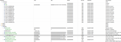

I have a very confusing problem here.
My chip model is S32K312.
The clock configuration selected is option B. The STM clock is 48M, and the INTM clock is 60M

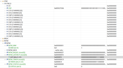

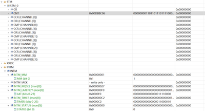

When the STM timing interrupt is 100ms, my test is as follows:
(0x00DBBC06 - 0x00927E0A)/ 48000 = 99.99    According to the value of STM.CNT, we can know that the STM interrupt is triggered as expected, but INTM_STATUS is still 0.
The value of INTM_LATENCY needs to be further reduced before INTM_STATUS changes to 1.
This is also the case when the STM timer interrupt interval is 300ms
I think already I have been very careful to use the INTM interface, but I still don't know where the problem lies

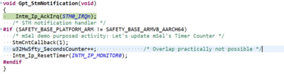

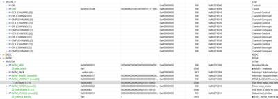

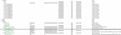

这个帖子我早就看过了,INTM这个模块并不复杂,只有几个寄存器,功能也比较简单,容易理解,但最后就是出现了令人费解的问题,你提到的这个可能性是不存在的,我提问的截图里有STM_CNT的数值,我的断点就是打在了callback中的Intm_Ip_AckIrq函数上,证明两次运行到Intm_Ip_AckIrq的间隔是符合预期的。我也怀疑过难不成STM坏了,改去监控PIT的中断,用STM_CNT作辅助验证,最后还是一样,PIT中断是预期触发,监控结果却总是出错,我注意到一个很奇怪的现象,观察寄存器,STATUS要想为1TIMER必须大于LATENCY的值,理论上,中断的周期是固定的情况下TIMER的数值每次应该相差不大,但我发现,在监控PIT的时候TIMER的数值会随LATENCY变化而不是中断周期,在监控STM的时候,STM周期变化很大,TIMER的值却几乎不变
附截图
