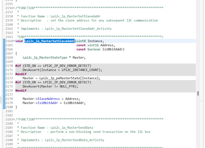

Hi@willy2
yes, use "Lpi2c_Ip_MasterSetSlaveAddr()"to change slave address.

I'm using the LPI2C0 as master and need to communicate with multi slave device.
assume 2 device with addr 0x10 & 0x20.
I see that when i do Lpi2c_Ip_MasterInit ,it will set slave address as 0x10.
if i want to trnsmit to other slave device ,what do i do it?
reset slave address with function Lpi2c_Ip_MasterSetSlaveAddr?
984 Views
Senlent
Hi@willy2
